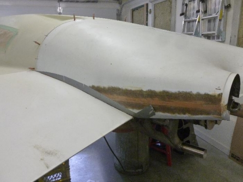

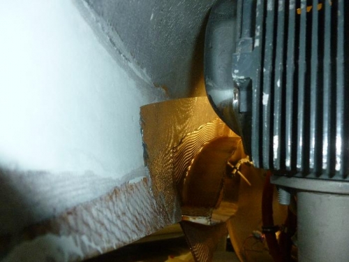

Brief Description:  3 bids on upper wing for cowling hinge.
The top wing was next to get ready for the hinge to hold the cowling into place. The top was ground and readied for the 3 bids for the hinge to attach too. I had the lay-up on a stick upside down and was pushed into placed and then flipped into position with great success. I used a mirror to see if it was in the right spot and very little movement was needed.
This is to be done with the engine not in place. It is a bit harder to do the glass work but I am happy with the turn out.
Sanded and ready for bids.
3 bids in place.
