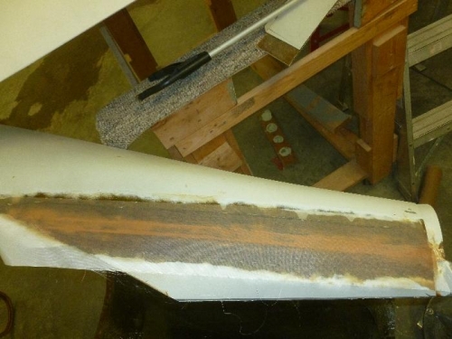

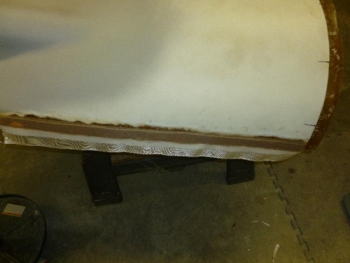

Brief Description:  Cut cowling and 1 bids on outside
I cut the cowling inline with the bottom wing to a flow in one direction. Everything and sanded and cleaned and micro added in the low areas and one bid with peel-ply added. I will trim when cured and the top wing needs the flange for the hinge next.

Outside has micro and 1 bid.
One bid on added area.
