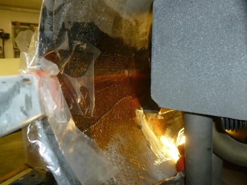

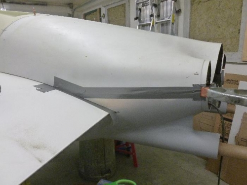

Bid the bottom to the top cowling
The bottom and the top will be joined and then a line cut in flow with the bottom of the cowling. 3 hinges will be used to hold the cowling onto the wing and it’s self.
Duct tape to have bids lay flat
3 bids (glass) inside of cowling
