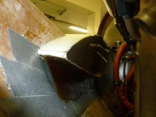

Brief Description:  3 bids onto bottom wing for cowling to attach too.

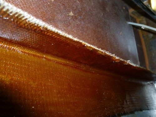

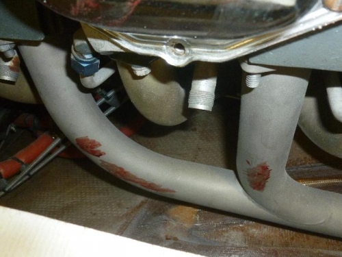

I ground the bottom of the wing and prepped for the glass. Duct tape the cowling and got into place for the bids. Wet everything out and placed. I went very well except for when I pulled my arm out it hit the end of the cowling and cut my arm. I still had to stipple the glass down and deal with the cut later. Blood, sweat and money on this build for sure.
End view of 3 bids.
End view of 3 bids.
It went well.
It went well.
Blood on the job.
Blood on the job.
