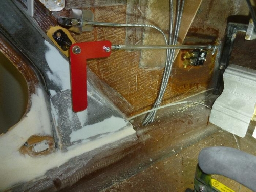

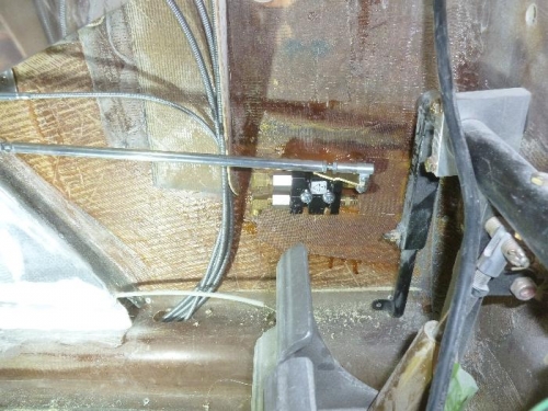

Brief Description:  Install park brake block and handle.
I worked on the parking brake system with mounting the block and handle over a few days letting the glass cure. It turned out really nice and should work fine holding the plane in place.

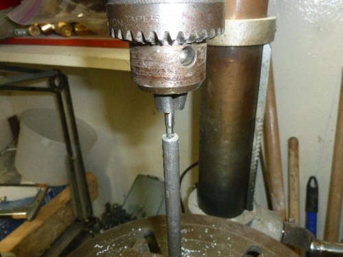

I did my drill and tapping with the drill press. The shaft was in the drill chuck for alignment then the vice was tightened and lowered for the hole to be drilled and then tapped by hand in the drill chuck. The rod was to long on the first set up and cut and re-tapped for the correct length.
Park brake block in place.
Pull to set brakes.
Pull to set brakes.
Drill press lath. Tap in hole.
