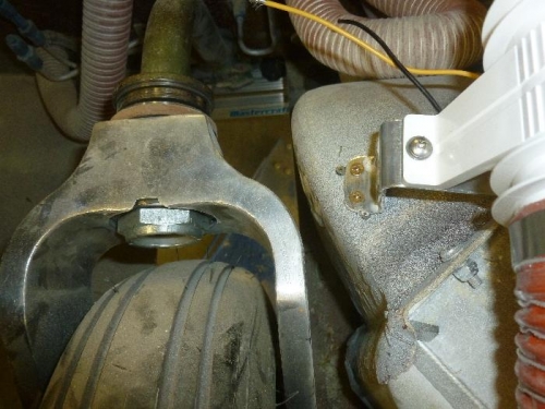

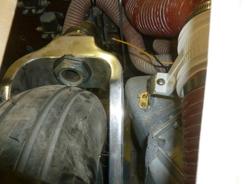

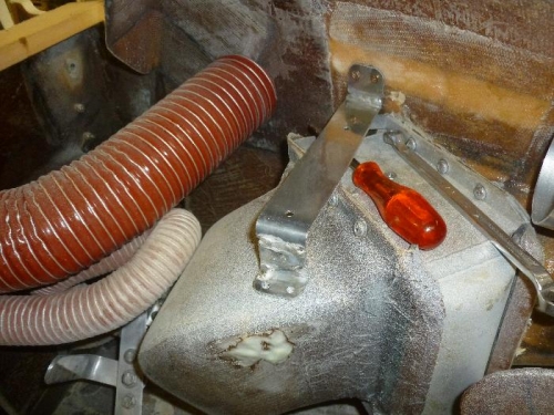

The fork was touching the recirculation fan bracket so it had to come off and get cut to fit the new location. Great clearance now in the full up and down swing.
Bracket cut and tig welded
Great clearance now
Fork has lots of room
