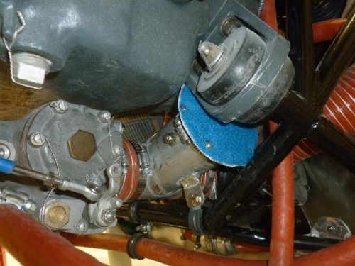

Brief Description:  Worked on securing cables and finished alternate a
It’s that time of the year for yard work to be done so the plane was neglected. Fire wood is almost done, this is a big job every year and the wood shed is full and the pile to season for a year is almost done.
I installed the alternate air source and cut the cable to length. I hope I never have to use it. But it is in and working very well. I used vacuum cleaner bag filters for the fine dust and bigger stuff for the bugs.

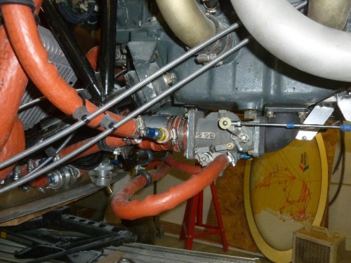

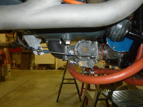

I secured the cables and fuel line hoses with short automotive fuel line and tie straps. It works really well to hold stuff in place and not vibrating.
Alternate air source in.
Throttle side is done.
Mixture side is done.
