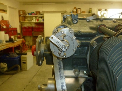

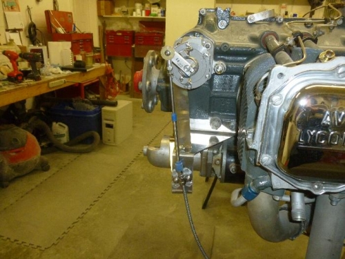

Brief Description:  I worked on the governor today.
I got a reply from MT – Propeller USA to my questions. Peter Marshall General Manager answered my questions and even tolled me more them I asked. Great service!! I was told to remove the safety wire for the screws and rotate the arm to the position that would work for my application and re- safety wire the screws. Peter also told me how to adjust once the engine is running, good to know. Thanks Peter!!!

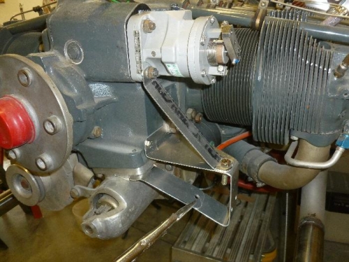

I finished the mounting bracket for the cable. I found that the wide washer jammed on the ball joint and the holes drilled were not in the right spot. Oh Shit I had to remove and tig weld the holes closed and re-drilled. I had to add small washers to move the big washer away from the ball joint arm and it all works great now.
Arm in the right spot and wired
Bracket getting more support
It works just great!!
