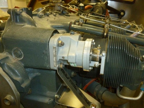

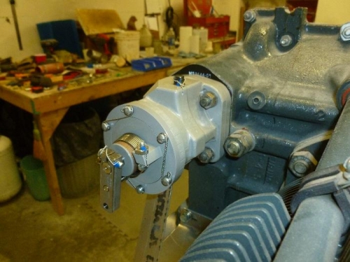

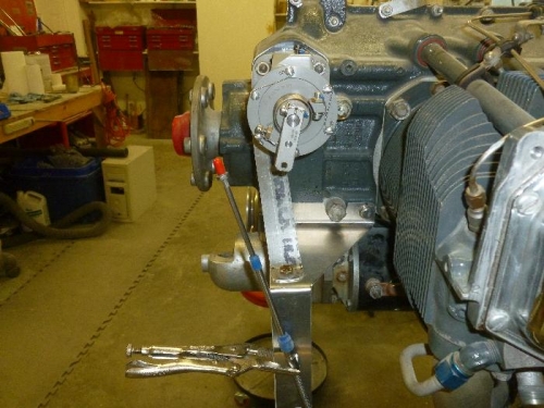

Brief Description:  Governor was put into place and making bracket for
I had changed the bolts to stainless on the throttle and mixture brackets. It was time to place the governor on the engine to see if it was the right one. It fit perfectly and now I need to make brackets for the cable to operate the governor.
The governor is for changing the pitch of the propeller to pull more air on cruse and fin pitch on take off and landing. Oil is sent to the end of the crank shaft at 300 psi to move the guts in the constant speed prop.

Bracket for cable.
Bracket for cable.
