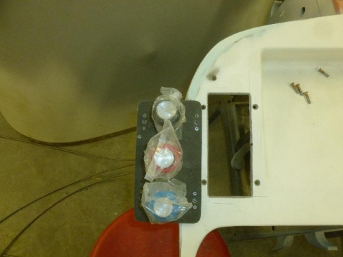

Brief Description:  Made plate for Throttle, Mixture, Prop for cable c
The triax carbon lay-up was ready to cut to shape and have the nut plates riveted on and then drill for the control cables to be bolted too.

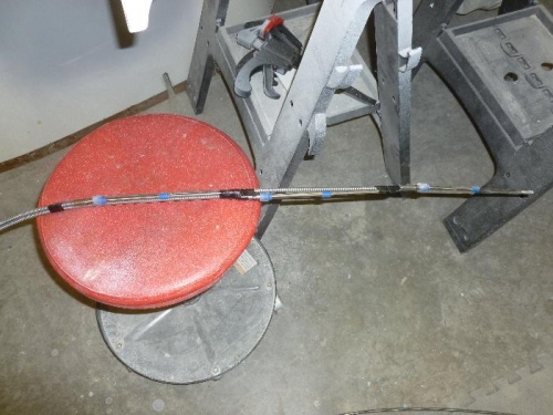

I staggered the cables and taped together to go down the fuselage duct. The hole was made bigger were the cables go into the duct to make a good sweep. It went not bad installing with a push and pull and then I had to move the oil lines at the back to have the cables come through the hole.

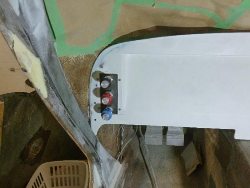

I painted on some water born vanish on the carbon plate were the knobs are located. I had to bolt it all together to see how it will look and pull the throttle to feel the power.
I will be working on mounting the cables at there locations on the engine next.
Mounting plate made.
All 3 taped togetter ready to go in
