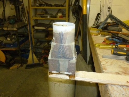

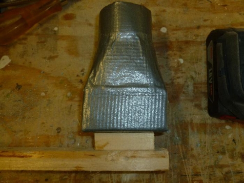

Brief Description:  Trim duct and made a new one for other side
Trimmed the one I made yesterday and had to destroy the foam mold to free from the mold. I had to make a new foam mold for the Co-Pilot side and then glassed up with 3 bids.

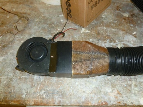

The little heaters come out of China and will put out 500 watts. I will have one on each side of the glare shield to keep the window clear. They will be on relays and the draw is 25 amps each. I will have to have the motor running to power them. I am really surprised how much heat they put out.
It fit perfect and will work

New one for Co-Pilot side
3 bids and peel-ply
