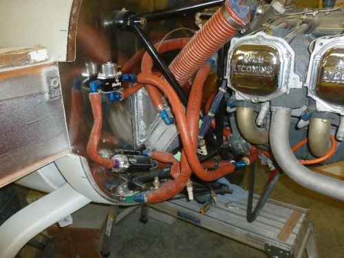

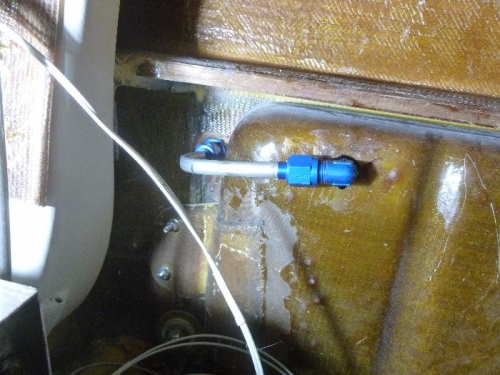

The return line to the tank had 3/16” clearance from the gear leg in the retracted action so I treaded the tank more and now the clearance is ½” and I feel better about that. I ran more lines from the boost pump regulator and this is almost done. The fuel out from the mechanical pump was made but some how I missed ordering the fire shielded. More stuff coming from Aircraft Spruce.
Return line to header tank

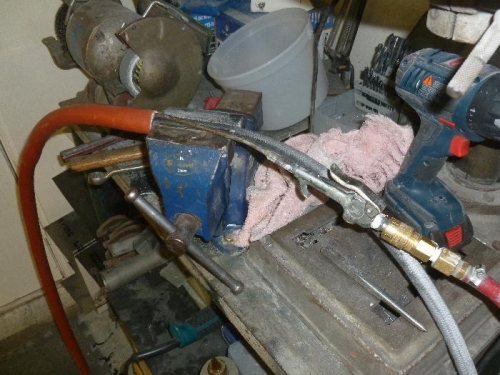

Compressed air help slide heat shield
More lines and looking good
