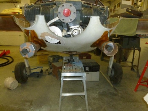

Brief Description:  Fitted exhaust cowling tubes for exhaust pips.

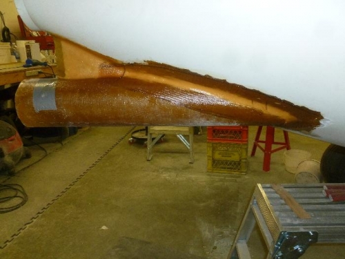

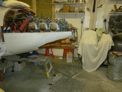

I can’t believe it took 8 hours to install the tubes but it did. I trimmed small amounts to get the best fit and have good clearance for the exhaust pipes. Once they were bondoed into place I ground more gel coat off were the bid was going to be placed onto the cowling. I then made foam gussets for the back and bondoed them into place. It was time to glass them to the cowling and this part only took 3 hours out of the 8. I will have to trim the tubes and the exhaust pipes to the right working length. Once I remove the cowling the inside will be completed were the exhaust levees the cowling. The pipes will also be wrapped in exhaust heat shielding tape to prevent melting the cowling exist point.
The back view
The back view
Pilot side view
Pilot side view
Co-Pilot side view
Co-Pilot side view
