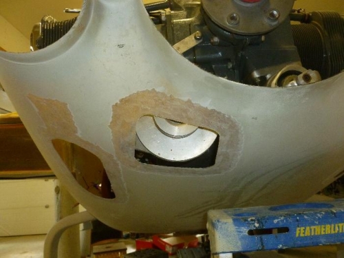

Brief Description:  Had to make room for alternator and made 4” tube

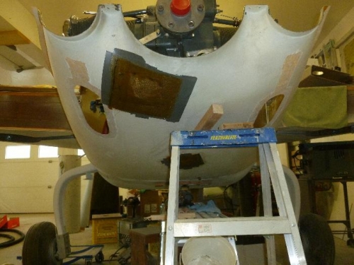

I hung the alternator and found it was hitting the bottom of the cowling so a hole for clearance was made and a cover was glassed up. The fuel fitting and alternator covers for the cut outs will be glassed into place when they are cured and trimmed to fit.

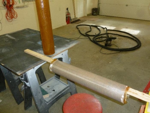

I also made the other 4” tube for the exhaust extension and will be removed from the paper tube when cured.
Cut out for alternator.
Lay-up for 4
Lay-up for 4"tube.
3 bids for bumps.
3 bids for bumps.
