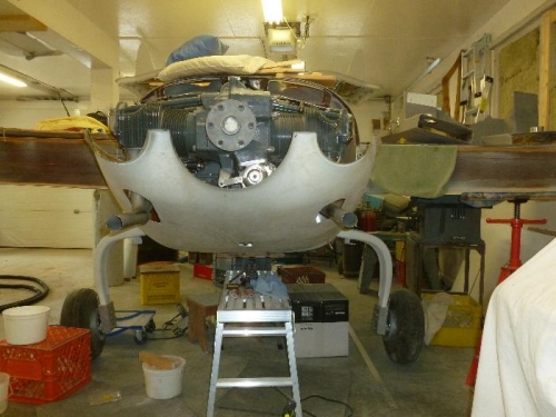

Brief Description:  Cut cowling for exhaust and made 4” tube.
I used a plumb to find a starting point for the exhaust ports and used a 3" hole saw to start the opening then connected the holes. There was a small adjustment made to the cut out hole and the exhaust now has good clearance. The 4” extension tubes will fit great when fitted to the cowling.

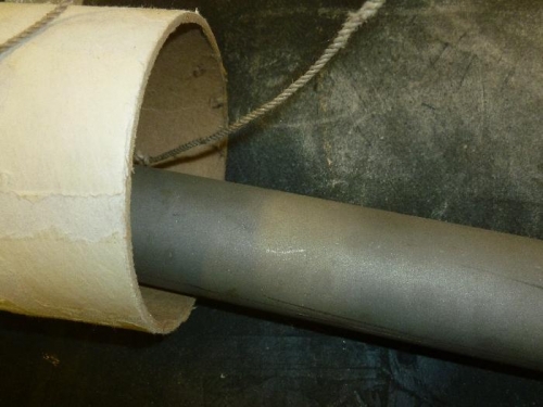

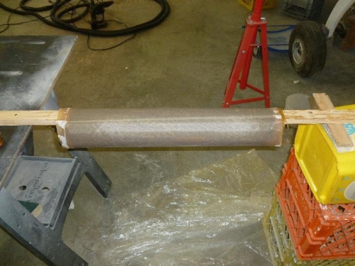

I used duct tape on the 4” paper tube and Vaseline for a release agent and I still had to slice down the middle to remove from the 4”tube. The Vaseline was just a mess and I will not use this again.
I used a string and a vacuum cleaner exhaust to blow air trough the 4” tube to see were the sweet spot for vacuum will be and will retest when it's glassed to the cowling.
Cut outs for exhaust.
Suction test with exhaust pipe
4" cowling extention
