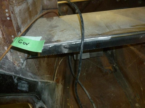

I did about 5 hours of looking at sites, pictures and Aircraft Spruce for the right cables to use for the throttle, mixture, and propeller governor, I will be using the A-1750 control cables for the propeller governor (17 feet), throttle (16 feet) and mixture (16 feet). The order went in today and this will be one of the projects for the weeks to come.

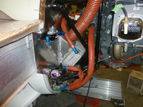

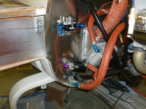

I added some fuel fittings and still waiting for parts to show up to do more plumbing.
The oil lines were next and they were a breeze to do, I looked at Youtube for how to do this and with the right tools and lost of oil, the fittings screw in really nice into the hose.
Measuring for cable lengths
Oil lines finished off
Fuel fittings added
Fuel fittings added
