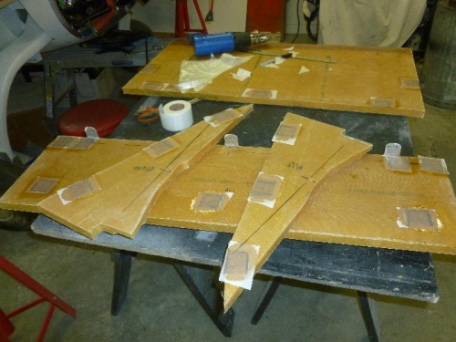

Brief Description:  Tabs, anchor nuts, and mount panel. 3 bid on holes

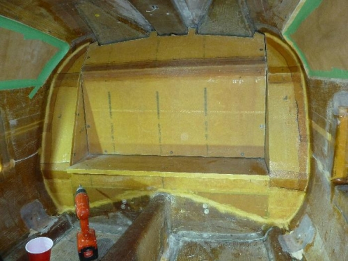

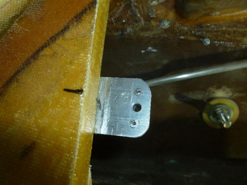

I placed the back big panel in the plane and wedged with the door wedges and drilled the mounting tabs and removed so I could attach the anchor nuts now. This was quite the job using a 90 degree off the drill to make holes due to limited space. Once they were all done I screwed the panel into place and admired my work thinking of what it would look like with upholstery on it. I then did 3 bids on the holes because the screws were pushing into the foam.
All installed ready for upholstery
3 bid on holes
3 bid on holes
