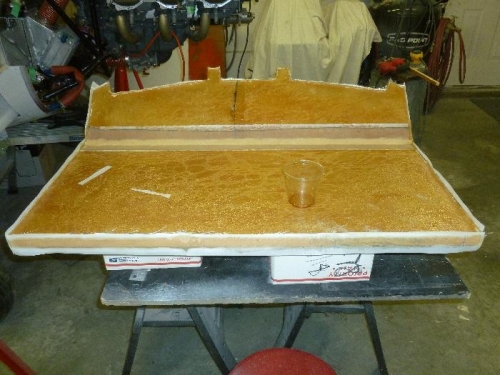

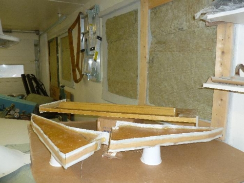

Brief Description:  Trim and add 1 bid on all the sides of the panel p
I removed the door wedges holding the main back panel in place and clean up the area were the center was glassed. I then dermaled the edges for the 1 bid to go on and mixed micro and resin for the glassing. I cut 3” & 4” bid to have in stock for work to be done in the future.
Sides are done on the sides
Sides on main back panel
