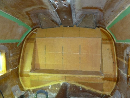

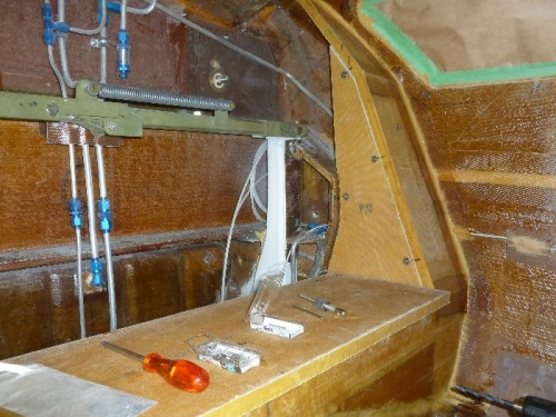

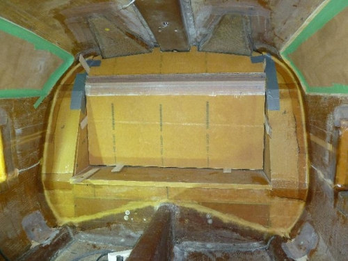

I worked on the rest of the anchor nuts, mounted the luggage shelf and the sides. Now it was time to clean up main panel and get ready to bid the center. I mixed up micro and added to both sides of the center joint and put the big lower main panel up into place and wiggled the bottom panel back and forth so the two sides would blend together. I used door wedges to hold into place and then it was time to add the 3 bids. Once curd I will bid the back. I have 1/8 all the way around for the upholstery and I hope this will be enough, if not I will adjust.
Anchor nuts done and stuff mounted
Dry fitting the back main panel
Fitted and 3 bids on the center
