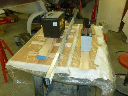

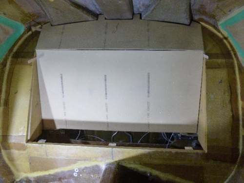

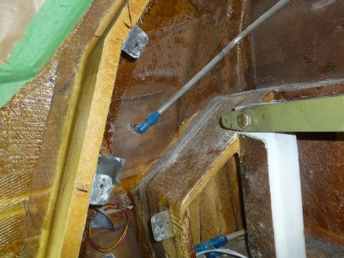

I used the cardboard template to see how far off it was and surprisingly it only took a few cuts to make fit. I had to add in a few spots so when it was traced out on the foam the needed spots were adjusted. I added were it was needed. When I was happy with the fit the epoxy was next, had to go down town for 1.5 hours so the resin was put into cold storage and when I got home the heat gun got it to flow again. The next thing was the anchor nuts they were drilled and riveted in place.
Foam fitted in place

Anchor nuts installed
