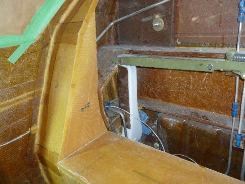

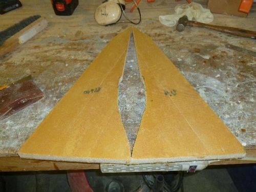

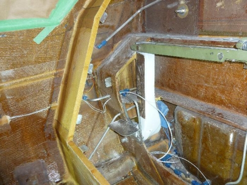

I started the day mounting the back luggage brackets and fitted the vertical sides and then it was time to make aluminum mounting tabs and then rivet and floxed them into place. Once they are cured I will drill and rivet anchor nuts to hold every thing in place. This stuff will have to come out for the annual inspection once a year when the plane is flying.
Cleand up with a razor knife
Fitting perfectly

Mounting tabs floxed in
