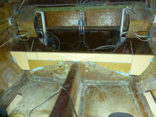

Brief Description:  Work on the bottom part of the back cover panel
I started by cleaning up the edges of the panel pieces. Cut off extra glass and sand to shape. The shelf will be to low for the battery to fit properly so I added 3” to the section that the shelf will sit on and now there is lots of room for stuff under the shelf. The section in front that the shelf will sit on will be gassed in permanently from both sides.
This will be glassed in permanent
3’ x 10” shelf for luggage
