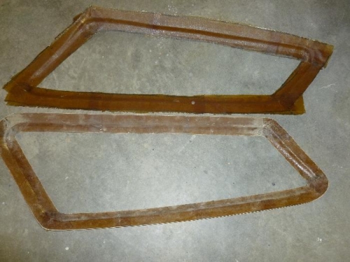

Brief Description:  Trim, sand, drill, and mount window frames.
I must say that I’m so happy that I made my own window frames and not try to fit the ones that came with the kit. I trimmed the newly made ones with the hack saw blade and sanded the edges smooth. I marked out for mounting screw holes and drilled so I could use clecos to hold into position as I then drilled the fuselage for the anchor nuts to be riveted on. Next was to rivet the nuts on and drill the frame to fit the screws used for mounting. One more thing off the list.
Trim and sand then drill

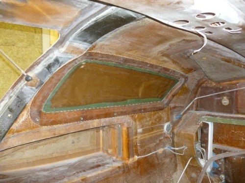

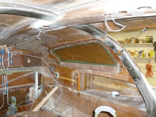

Co-Pilot window frame
Pilot side window frame
