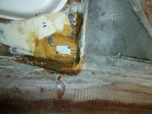

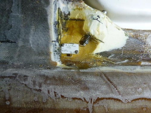

Brief Description:  Mount door micro switches and spring pin actuator
I found some springs at Home Hardware and weld nuts on one end and cut to length so when you lock the door closed the door pins push on the spring and in turn activates the micro switch with the red light going out. Doors are closed.
Spring pushing switch
