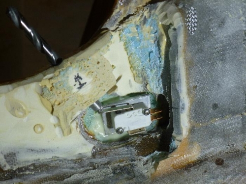

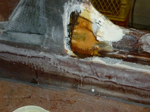

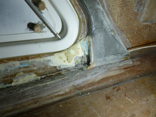

Brief Description:  Install door open micro switch
It was time to install the door open micro switches on the ends of the locking pin. I started by grinding to find the pin receiver and cut to length with a cut disk. Next the area was opened up with a dermal to make room for the hard point for the micro switch. The hard points that came with the kit were too small and I made new ones out of left over stock from the kit. I drilled and taped for the screws, dry fit and used 5 minute epoxy with flox to hold into place until I bid them in. I now finished with 1 bid and will trim when cured.
