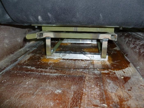

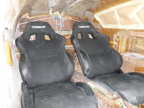

Brief Description:  Install back seats and clean up
I removed the peel-ply cut the glass over the mounting holes and ran a tap down the threads so the bolts would go in nicely. I marked the quick release rails and drilled and bolted to the seat sliding rail and then the other part to the fuselage hard points. The old body did not wont to climb over the seats to well so one side was done and then slid foreword and the other seat tilted back so I could climb into the back and drill for the quick release pins.
The seats are really dusty from the micro dust and will need a good cleaning for the final install.

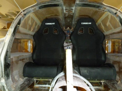

I then cleaned the work area up and drove the seats out to the hanger for a few more years of hibernation.
The seats are done and the mounting rails now will get a coat of paint and go out to the hanger.
Passengers have a place to sit
Quick release pins in place
Long flight sleep position
