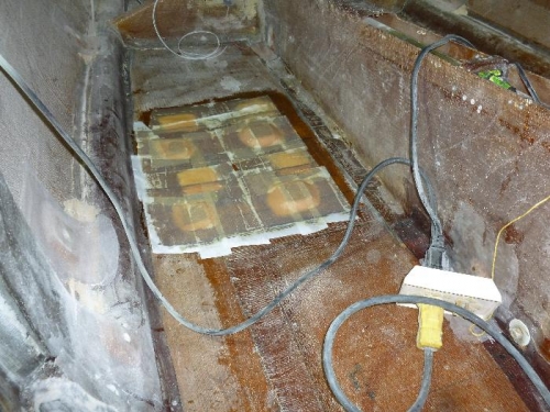

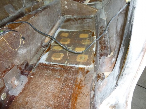

Brief Description:  Clean up and 2 bids on hard pionts for back seats
I had to pry off the seat rails from the hard points with a screw driver this morning to see a few drops of flox/micro mix had gotten between the two items. It proves to me just how strong the EZ poxy flox/micro mix is.
I sanded the area up to get ready for 2 bids to go on the hard points and the old hard point spots will be filled in.
The 2 bid was done next with peel-ply and the heat gun.

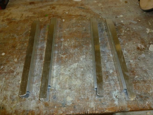

I then cut the quick seat attach rails for tomorrows install.
I also changed the hose clamps on the scat hose to a smaller size so the extra will not be hanging in the wind. -_-
Pilot side done
Pilot side done
Co-Pilot side done
Co-Pilot side done
Quick attach rails for seats
