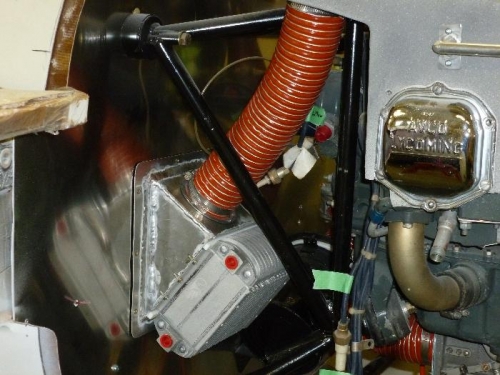

Brief Description:  Flanged for oil cooler installed, Scat added.
I removed everything and drilled (4) 1/8” holes in the 3 “flanges to be silicone and riveted onto the oil cooler housing and the air plenum. It was then screwed back into place.
With the plenum off I re-picked the engine plugs. The stuff was micro waved for 2 minutes to remove all moisture and placed back into the glass tubes, then back into the engine plug holes.
It was also a day of Christmas shopping, skating and swimming at the aquatic center with my daughter Morgan. Fun time it was!!!
Scat is on, plumbing next.
