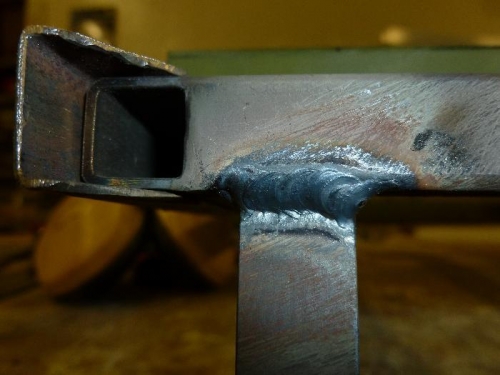

Brief Description:  Cut and weld back seat rails for height
I used a zip blade on my angle grinder to remove the bottom mounting rails and cut to length. One end had to be lengthened so that came from the front part of the rail that was cut off, things were prepped and I Tig welded the rails back on to the slide.
There are at the right height
