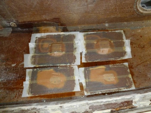

Brief Description:  2 bid on Co-Piot seat hard pionts
The peel-ply came off the Pilot side hard points and a hobby knife was used to cut the glass away from the bolt holes. I drilled past the treads so the bolt will not push the hard point up the drill used was 4 sizes smaller then the dill size for tapping.
I mixed up flox and micro balloons for the Co-Pilot side hard points and radius the aluminum for the bid to go over. The bid was placed and Peel-Ply heated out to absorb and smoothen the resin out.
Co-Pilot side done
Co-Pilot side done
