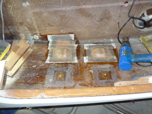

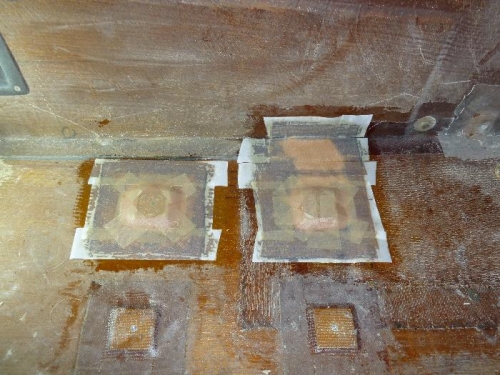

2 bid on hard pionts
After the structural resin was set I prepped the area for 2 bids of fiber glass cloth to go on. I had to add micro and flox mixture to transition correctly and on went the glass with peel-ply to make smooth.
Pilot side 2 bids
Co-Pilot side 2 bids
