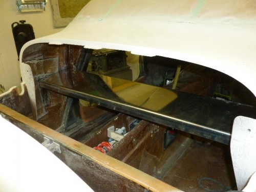

Brief Description:  Finish the install on the avionics shelf.
I finished drilling and riveting the blind nuts in place on the triax brackets. I shelf just fits if you swing it up and then down onto the Co-pilot side and then screw in the Pilot side and lower into place. All the electronics and auto pilot servo for the glass panel and elevator control will go onto this shelf.
Avionics shelf now in place.
