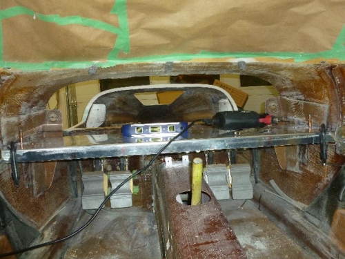

Brief Description:  Installed avionics shelf.

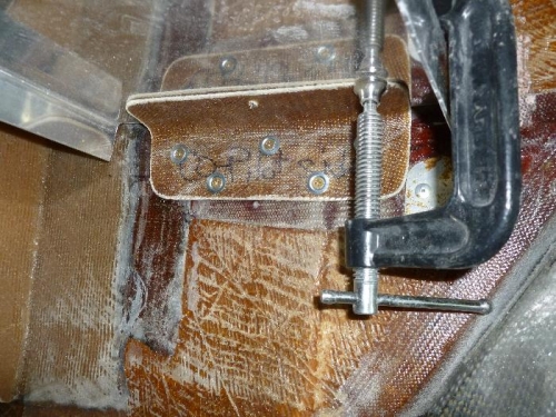

I got things marked out and drilled holes and clecoed the brackets in place for the other holes to be drilled. The blind nuts were installed next and the Co-pilot side screwed into place. I have just enough room to get this into place with one bracket attached. I have ¼” clearance on both sides and I’m happy with that. The tray was positioned and 2 clecos in to hold over night.
The new jacks are great for leveling the fuselage so I could get this done correctly.
Brackets in place with blind nuts

Wow it is level with the fuselage
