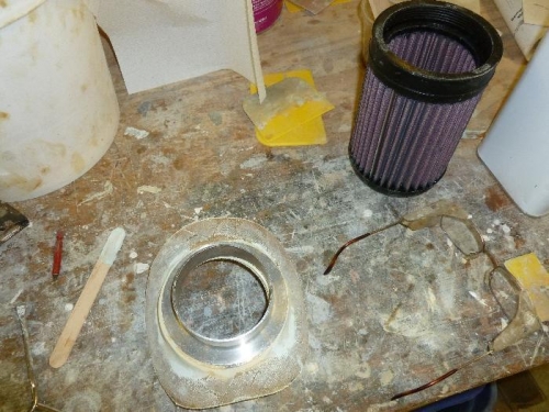

Brief Description:  Cleaned up side flange and make air cleaner flange
I used a putty knife to remove the side flange from the coffee can and cut to a nice shape. The inside was cut and cleaned up so the aluminum air intake hose flange had a level surface to go onto.

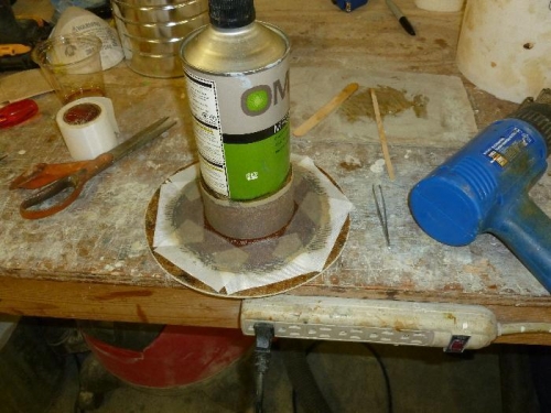

It was time to make the flange for the bottom that the air cleaned will go onto. I used a reducer can and duct tap to get to the right size.Vaseline on duct tape worked just great for release. I did an estimate on the amount of duct tape with peel-ply to come to the right diameter to have a good fit. After trimming and sanding it was perfect, sometimes thing work out!!

Making air cleaner flange

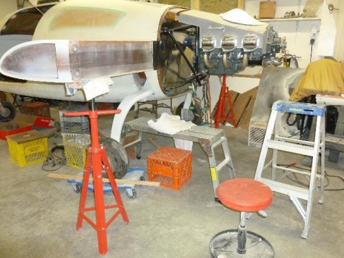

New stands Much safer
