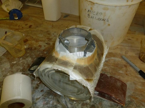

Staring to make the air cleaner can

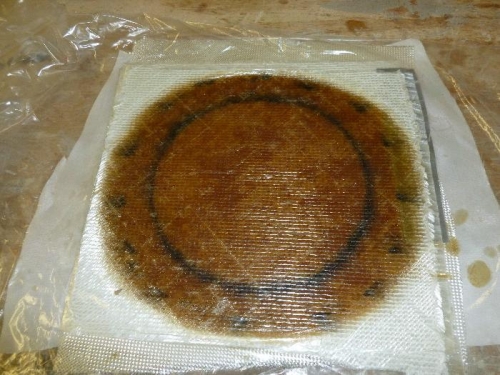

I wet out 2 triax and one bid for the top of the coffee can air cleaner box. A flange will mount to this and go to the engine.
The side will be the fresh air from the air plenum. This part will be siliconed on and riveted.

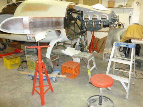

O the plane Jacks showed up today and were assembled and put into place. I can now go back to working on the landing gear doors
Air intake side
Top of air box
New plane jacks.. Insurance
