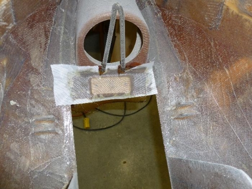

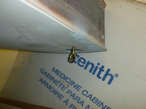

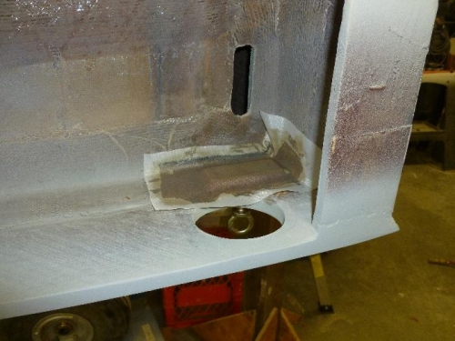

I used a 90 degree drill attachment to drill the holes from the inside of the strake and just in front of the spare. The holes were enlarged to ½ “. I then used the angle die grinder to sand up the glass and the hard points for the milled/flox to hold onto. The treads had Vaseline applied and the hard points were placed. 2 bids on top and peel-ply to finish.
Hard points in place
Tie down eye
Tie down eye
Front one in place
Front one in place
