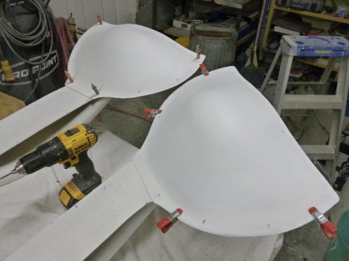

Brief Description:  Nut plates for bootie bump cover

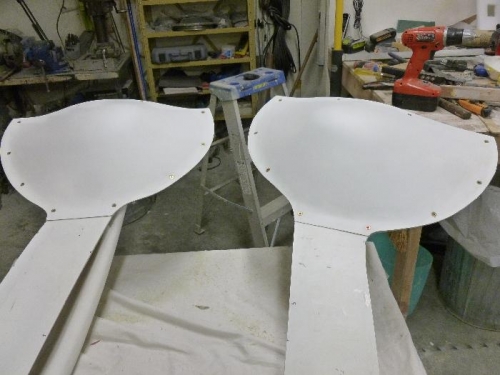

I marked out were the holes are to go and drilled a size for the screws to pass through. Nut plate rivet holes were drilled counter sunk and attached. I screwed the cover into place to see how it will look. I did forget to add the washers that go under the screw to help displace the pressure. Just some fine tuning on the doors and covers now.
I need to make some steel screw jacks for lifting the plane, the wooden ones are not the safest and so far have worked but with the engine on now there is a lot of weight at the back. Next weeks job.
Marking and drilling holes
Nut plates riveted and screws in
