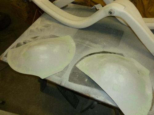

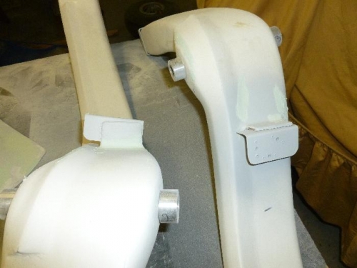

Sand and spray sealer on
The micro was sanded and sealer primer was sprayed out and. When it was dry I used Spot Lite bondo on the pin holes and small imperfections.
Spot lite time for pin holes
Sealer primer sprayed on
