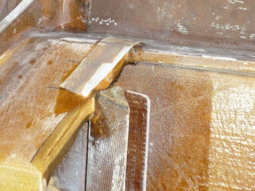

Brief Description:  More bid work in the gear leg socket area.
I removed the legs and used the electric hack saw to make the opening bigger so the legs go in and out easier. There is a peace of foam with TRAX on both side’s above the ear leg bolts and I cut off ¾” in height to have the legs go in and out with out scratching the primer and some day the paint. I will add 2 bids for strength for the removal of foam and glass.

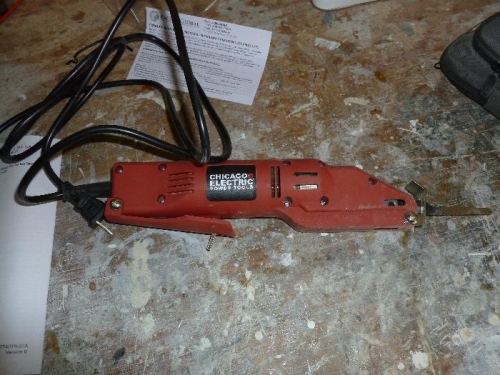

The electric hack saw is amazing I wish I had got this in the first place and not the air saw.
Someone on VOBA had mentioned this saw from Harbor freight so it was a must to get.

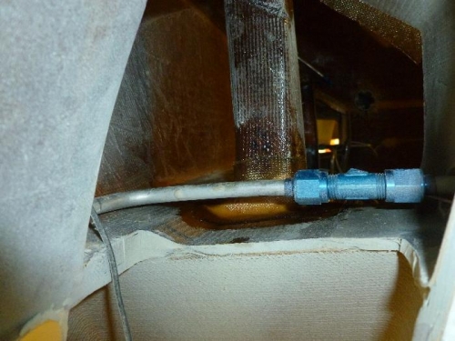

Back bottom with 2 bid on
Top work done. More to do
This is one handy tool
