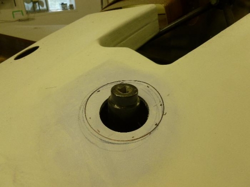

Brief Description:  Work on the oil filler access trough plenum

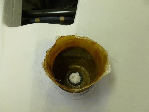

I drilled a hole to see how close I was to the filler and my measurements were out to lunch. I got out the 2.5” hole saw and made a hole big enough that a socket could fit on the top of the filler tube. I then measured so that I could center a 4” coffee (both ends removed) can on top to trace out a circle that the 1 liter honey bid form funnel would fit into. A little filing and it was ready.
Socket on oil filler for measurements
It fits!!  Now to trim

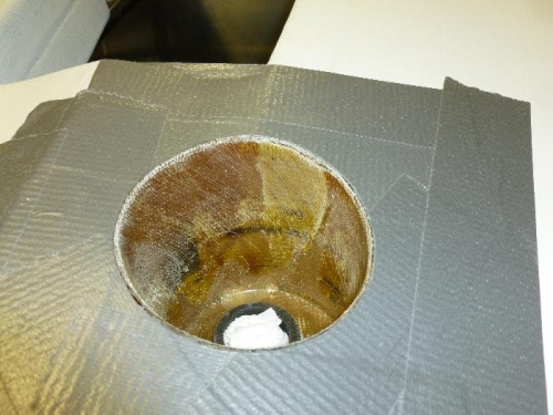

Ready for flange
Ready for flange
