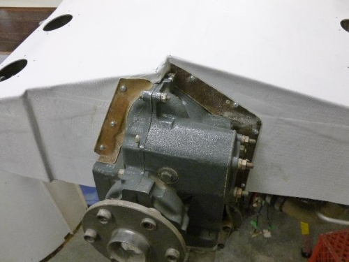

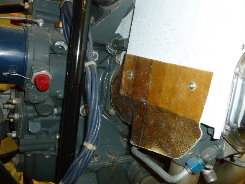

Brief Description:  Bolt on baffles to stop air from escaping
I trimmed the new made baffles and drilled for the nut plats to go in. The rivet arrived today and the nut plates were installed and now it is time to bolt up and see how it works. It should work good keeping the air from going out and not through the head fins. I also did a 3 bids lay-up on a honey container that will be used for the oil dip stick tube from the filler to the air plenum.
Trimmed and bolted on.
Back one in place to seal up
