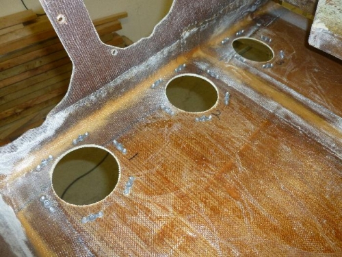

It took longer then anticipated to install the 72 rivets onto the 36 nut plates. Now that I see the numbers I see why it took so long. I trimmed the spark plug caps as I went. The rivet holes were filled because they were counter sunk and after sanding the primer went on. I have more to do to have a very good seal and have all the air go trough the head fines.
Nut plates are on
Nut plates are on

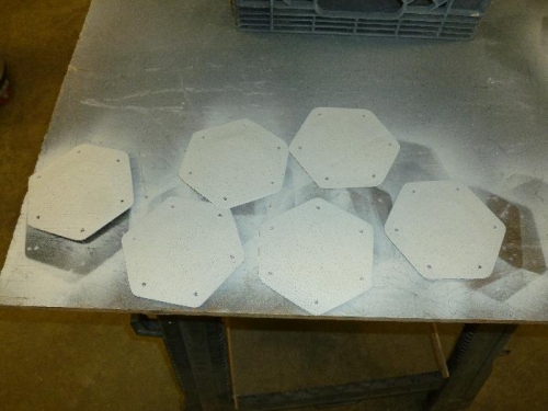

Caps trimmed and primed

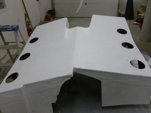

Plenum has primer on
