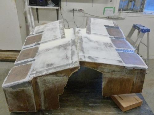

I sanded the air plenum and drilled 3” holes to access the spark plugs. Triax was wetted out and placed over the 3” pugs, the patches will be cut to a round shape to seal off the plug holes.

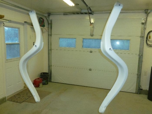

The main landing gear was sanded and a few spots filled and sanded again. Smooth prime was applied with 3 coats and should be close to paint.
Sanded and primed
Sanded and primed
3 " holes made for spark plugs
Access doors will be made
