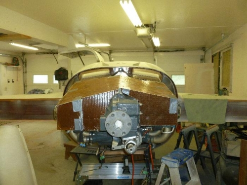

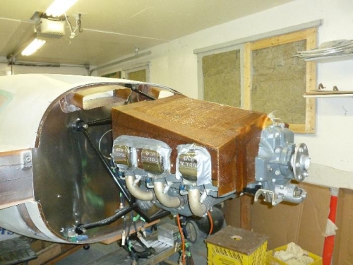

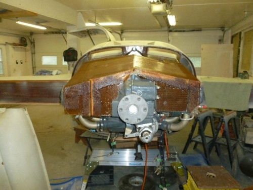

Brief Description:  Worked on air plenum
I finished fitting the top and then used 5 minute epoxy and flox to attach the top and let set for lunch then I sanded everything for the bid to go on. I added 2 bids (fiberglass cloth) to the joints and ends to hold this air box together. I will do the inside and add one layer of triax on the ends for strength, right now the ends seam to move very easily so this needs to be fixed. Once the box is done I will work on the intake from the NACA scoops.
