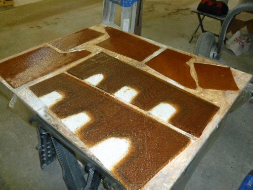

I mixed up resin and wet out the peaces that are to make the air plenum. The factory sells a plenum but I will try to make one. The section at the motor mount is wrapped in plastic so it can be curved around it.
Parts are glassed up

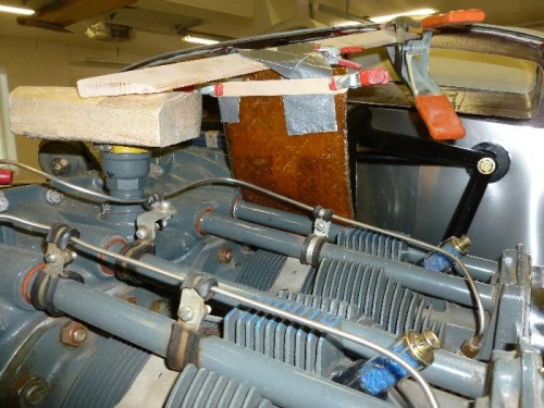

Supported in place
Get around mount
