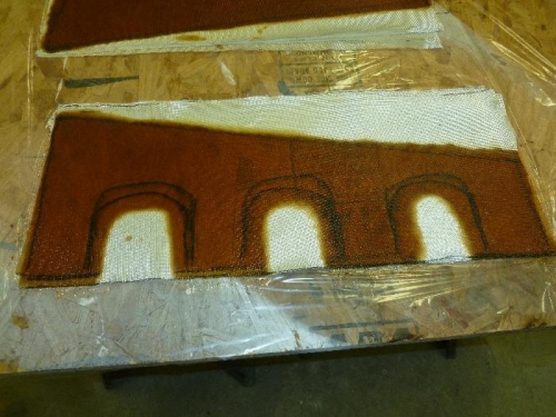

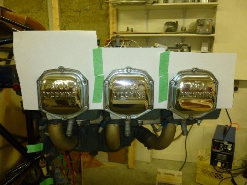

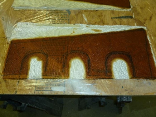

I started measuring and laying out the cylinder head template with paper and then cut 4 bid for each one. Plastic was placed and one bid was laid down and felt marking the head location. The resin was added and the heat gun used to flow out with the brush as the 4 bid wetted out one at a time.
I will be doing sections and then glassing together on the engine and have a way to removed for maintenance.
Paper template is make
Co-Pilot side curing
Pilot side cure time now
