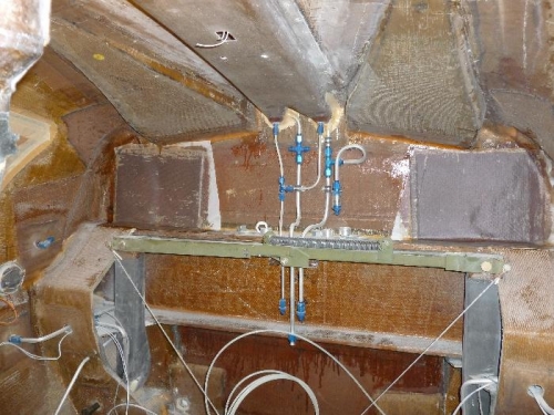

Brief Description:  Triax added at bolt hole locations
I got 4 layers of Triax in the bolt hole locations. The Triax grain goes in both directions and tie into the main spar it should be over kill here! but a departing engine will not be good.
