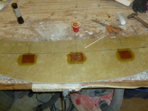

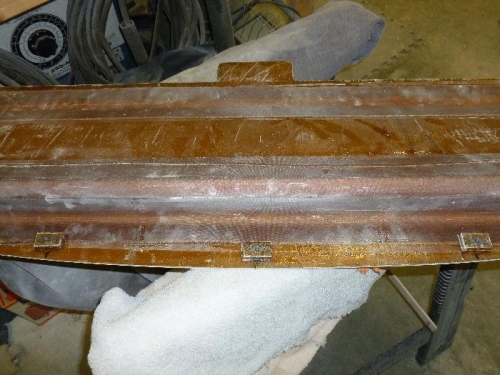

Brief Description:  Getting things ready for mounting the glare shield
I tried to fit the shield and come up with a measurement that will have the right angle for looking at the instrument panel and not get in the way of visibility. The shield will protrude 3.5” over the instrument panel and this was the measurement that will work for me. Extra glass was added to the shield for the nut plates and also to the instrument panel. I will bent some aluminum and cut to length and screw on and then work on mounting the back of the glare to the fuselage.
Nut plates to hold shield
Something for the rivets to bite
