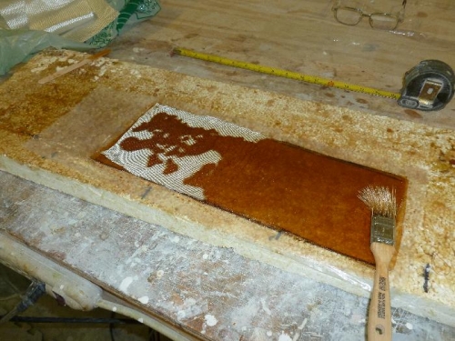

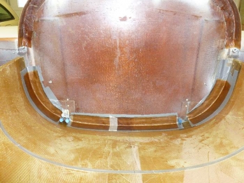

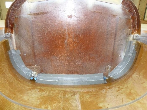

I got things cleaned up from yesterday and stared on the bottom cowling. The extended flange on the cowling was cut to 1.5” and then clecoed into place. Duct tape was applied and the bid wetted out and placed. I will let cure and remove tomorrow and then flox in place.
Duct tape in place
Duct tape in place
Heat gun flows out resin
3 bid in place
3 bid in place
