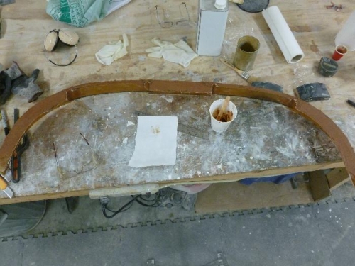

The top cowing flange was resined and floxed into place tonight. I removed the cowling to see if any resin had gotten onto the cowling extension flange and all was good so back on it went. The cowling extension flange was cut ¼” short of touching the firewall and the resin was just on the flange that would go onto the firewall. I will use all the clecos on the cowling extension flange when measuring for the engine. Once the cowing is attached to the wings I will fill and blend the fuselage and cowling area.
Resin and flox on flange
